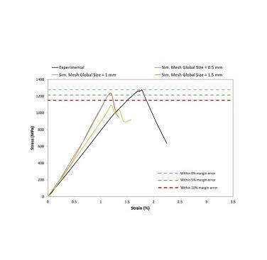

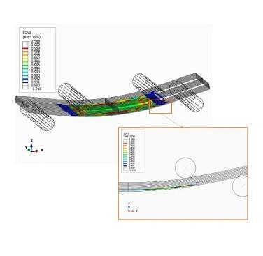

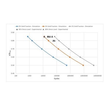

- Modelling Damage in Composite Materials
Composite materials are used in a wide range of industries to realise benefits including reduced weight, better corrosion resistance, lower whole life cycle costs, improved thermal, acoustic and vibration properties and no requirement for hot work when retrofitting. However, assessing damage in composite materials via testing can increase costs and lead times. To address this, TWI has investigated the feasibility of using modelling tools to study damage initiation and propagation in composite materials. This was based upon our understanding of material properties obtained from standardised experimental tests and an evaluation of existing techniques for damage modelling. From this we were able to verify and validate a selected modelling approach by comparison with benchmark samples. This project studied two aspects of modelling damage in composites; damage initiation and damage evolution - both in aerospace grade carbon fibre reinforced polymer, T700-M21. This included the study of damage initiation and evolution via continuum damage mechanics (CDM) and experimental results generated from static four-point bending tests. The study showed the promising value of using virtual testing to support the analysis of composite parts, either during the design phase or during the integrity assessment of in-service structures. In addition to conventional approaches using readily available commercial finite element software capabilities, TWI’s phenomenological approach to the study of damage in composites, involving a framework of experimental and modelling activities, achieved a closer representation of the behaviour of real materials for industry (Figures 1-4).

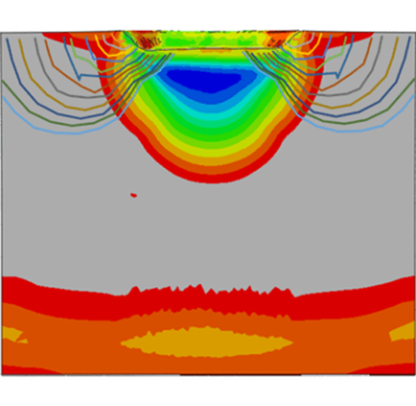

- FLECTION: Fatigue Life Prediction for Greener Air Travel
Funded by the European Union's Horizon 2020 research and innovation programme, the FLECTION project saw TWI work alongside experts from the University of Cambridge and RTM Breda of Italy as part of the ‘Clean Sky’ European research initiative that aimed to reduce CO2 emissions as well as lowering the levels of noise produced by aircraft. The FLECTION project focused on the development of the contra-rotating open rotor (CROR) engine concept, which has been shown to offer massive reductions in fuel burn and CO₂ emissions but creates more engine noise for both passengers and people on the ground. TWI assisted with fatigue predictions for the CROR engine blade, taking account of residual stresses from nicks, dents and scratches. An extensive experimental campaign was performed to characterise the material (Inconel 718), measure the properties of the damaged material, and provide data for the computational model validation. This included characterisation of the elasto-plastic, fracture and fatigue properties of the undamaged material (at room temperature and 550°C), and four-point bend fatigue testing of the damaged material. The computational model was calibrated and validated with experimental data provided by the partners, providing a useful tool to support the design of turbine blades (Figure 5).

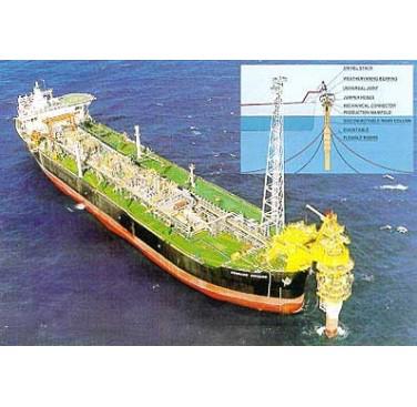

- Fitness for Purpose of Duplex Stainless-Steel Risers
TWI provided reassurance to Single Buoy Moorings (SBM) Monaco, who had themselves been commissioned to design and build an offshore floating production, storage and offloading (FPSO) vessel to be used in the Wanaea and Cossack fields off NW Australia (Figure 6). During pipework welding, SBM discovered unexpectedly high hardness values outside the design requirements in the weld zones where duplex stainless steel had been used for the rigid arm and riser piping. Example welds were sent to TWI where we were able to confirm the high hardness values, but otherwise considered the weld to be perfectly normal. To confirm this, TWI conducted a range of simulated environment tests, including slow strain rate (SSR) tensile testing and four-point bent beam tests at elevated temperature and pressure in a hot, sour brine solution. The H 2S and CO 2 contents were used to simulate field conditions. The tests established suitability of the welds for service, showing that the high hardness values were related to the strain induced by welding, which was not likely to be a problem under service conditions.

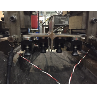

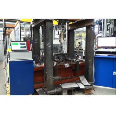

- Detection of Fatigue Crack Initiation on Welded Joints
Four-point bend testing was also part of a research project investigating the detection of fatigue crack initiation on welded joints under bending loading using acoustic emission (AE). TWI aimed to demonstrate the advantages of using AE monitoring in standard fatigue bending tests of welded joints, with the tests being based on standard fatigue test requirements in which specimens are subjected to four-point bending load conditions to determine S N curves (Figures 7 and 8). This project’s objectives were to detect crack initiation and propagation in welded steel structures (specimens) during fatigue bending testing using AE, and then quantify the accumulated damage of the structure, using the recorded data to inform future AE pattern recognition for damage of welded structures. Fatigue tests were performed according to a specific standard bending test for welded joints and monitored with a Vallen AE acquisition system, using four-channel VS150 sensors to verify the repeatability and accuracy of the accumulated damage identification and crack initiation. This project showed that the AE monitoring technique represented an accurate method of identifying crack initiation and crack propagation, and a potential solution for structural monitoring.

Figure 1. Comparison of constant strain rate (CSR) simulated data with experimental CSR data
Figure 2. Representation of damage initiation using a CDM-based model: The damage occurs by matrix failure in tension at the outermost 90° ply

Figure 4. Example of fatigue master curves generated as a function of void volume fraction and applied stress. The experimental data points for composite laminates with a void fraction ranging between 1% and 2% are observed to be in between the simulated master curves obtained from FEA models containing 1% and 3% void fraction

Figure 5. FLECTION project - Fatigue crack front propagation on the compressive residual stress contour plot
Figure 6. Floating production, storage and offloading (FPSO) disconnectable turret (Courtesy Single Buoy Moorings Inc.)
Figure 7. Experimental setup with Vallen AE system and bending machine
Figure 8. Joint welded steel specimen with the installed VS150 AE sensors
