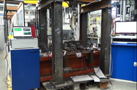

The tests involved were based on standard fatigue test requirements in which specimens are subjected to four-point bending load conditions to determine S‑N curves (Figures 1 and 2).

Tests were performed according to a specific standard bending test for welded joints. They were monitored with a Vallen AE acquisition system, using four-channel VS150 sensors. The work programme comprised a set of fatigue tests to verify the repeatability and accuracy of the accumulated damage identification and crack initiation.

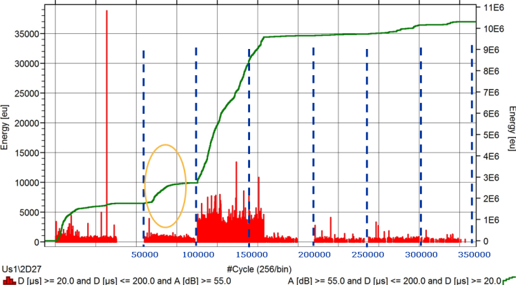

During the fatigue tests a soap solution was applied over the cracked zone to track its growth. Results can be seen in Table 1. The comparison between Table 1 and the AE results shown in Figure 3 proves the good correlation between the crack growth and the AE energy. This shows clearly the advantage of using this monitoring method for early identification of crack initiation, which is not possible using the traditional strain measurement or other parameters.
Table 1. Crack size propagation identified using the soap solution at different numbers of cycles.
Cycles 50mm 60mm 78mm
2c (mm) a (mm) 2c (mm) a (mm) 2c (mm) a (mm)
50000
100000 9 0.3 5.3 0.4
150000 11.1 0.5 7.0 0.6 3.5 0.3
200000 22 1.0 4.4 0.5
250000 27 1.8 5.5 0.8
300000 54 2.8
340368 71 3.7
349159 74 4.4

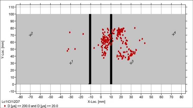

With the adopted AE software it was also possible to identify the locations of the accumulated damage to the structure. Figure 4 shows the location of the acoustic emission events associated to the damaged weld, based on the propagation time of the signals from four different sensor positions.

Figure 1. Experimental setup with Vallen AE system and bending machine

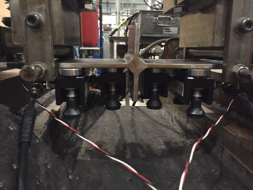

Figure 2. Joint welded steel specimen with the installed VS150 AE sensors
Figure 3. Acoustic emission results: amplitude peak energy on the left axis and cumulative energy on the right, per number of cycles
Figure 4. Damage locations' identification
