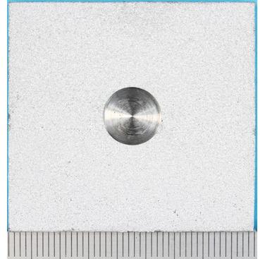

- Damage Tolerance of Thermal Spray Aluminium (TSA) Coatings
As well as creating new and innovative coating and surface engineering solutions, we have also used our technical excellence to assess the damage tolerance of thermal spray aluminium (TSA) coatings. TSA coatings are frequently used in marine environments where they are used to coat offshore structures made from carbon steel in order to prevent corrosion.
Although these coatings have been used for decades and industrial standards have been developed by ISO, AWS, NACE, SSPC, DNVGL, ANSI and NORSOK, it was not always clear how these coatings performed over long periods of time in the presence of significant damage. Our experts worked on a project to assess TSA coating corrosion rates in seawater over a longer period of time, adding to and extending the existing data available to industry.
Figure 1: 40mm X 40mm specimens before testing showing holiday (defect) size and distribution - the percentage of defect area is approximately 5%
