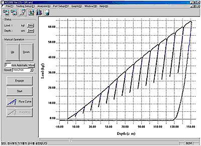

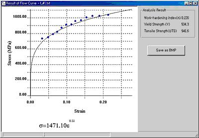

Fig.2. Load-depth curves and the stress-strain curve predicted
