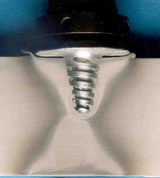

WhorlTM FSW tool in front of a section taken from weld in 75mm thick AA 6082-T6
A second generation of Whorl™ friction stir welding tools has been developed through TWI’s Core Research Programme. These tools have sophisticated profiles on the pin and shoulder and are made from wear resistant materials. Aluminium alloys of up to 50mm thickness can be welded in one pass. Thicker plates, of up to 75mm thickness, are typically welded in two passes from both sides. The benefits are as follows:
  • Very encouraging tensile, fatigue, deformability and ballistic impact properties
  • No joint preparation is necessary, even when butt welding 75mm thick plates
  • The welding speeds are higher than those of mechanised MIG welding when welding plates of more than 10mm thickness
  • Low distortion and high reproducibility
