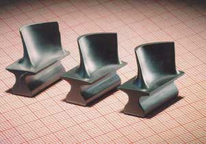

Engineering ceramics can be made in a wide range of sizes and shapes. The turbine blades shown here are an example of the complex shapes that can now be achieved with the advanced fabrication methods available to the manufacturer. These blades have been manufactured to the high material and dimensional specifications demanded by the aerospace industry.
The blades illustrated are made from silicon nitride (Si 34). This ceramic is one of the many high performance ceramic materials available to designers. The material has a number of desirable properties that make it attractive to the aerospace industry:
