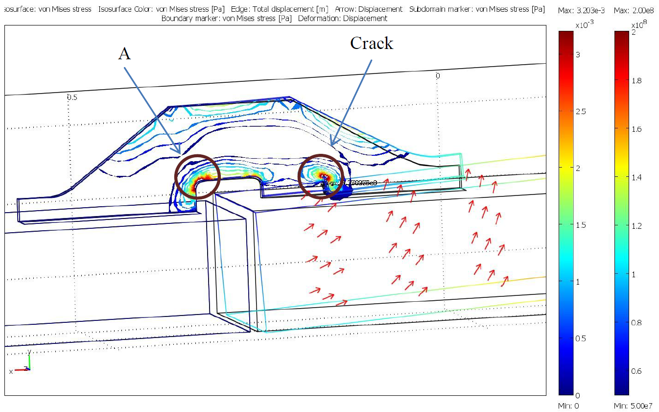

Modelling results – reinforcing plates

In the initial stages of the project, tests were performed on a crane, in collaboration with the project’s end user Cargotec. The crane’s critical areas were identified. Its reinforcing plates were shown to be submitted to the highest equivalent level of stress compared to the crane’s other components, so much of the effort was directed into covering this area.

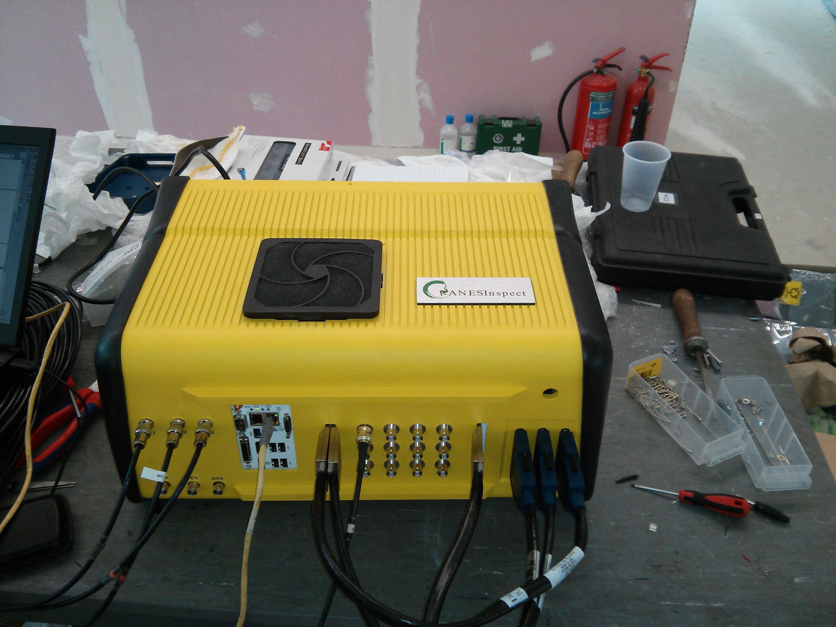

Prototype system developed during the project
