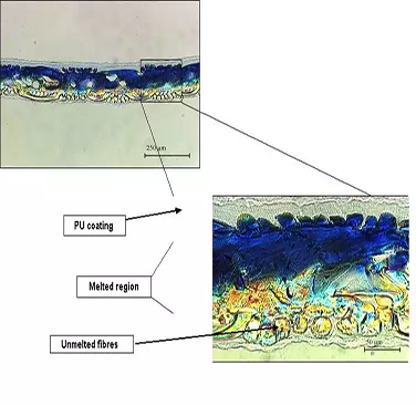

A more flexible welding solution uses transmission laser welding (ClearWeld™ - see www.clearweld.com) to apply a well-controlled amount of heat, just to the contacting surface of the fabrics. This selective heating is achieved by introducing a low visibility laser absorbing coating onto one or both of the fabric surfaces. Resulting beneficial features of the process include:
Fig.1: Weld between blue and yellow nylon fabrics showing region of fused material in the centre and unmelted fibres on the outer surfaces

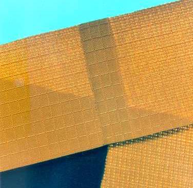

To date the ClearWeldTM process has been applied to pure synthetic fabrics (see Fig.1), blends of synthetic and natural fibres and to waterproof laminates (see Fig.2).

Fig.2: Waterproof laminated fabrics welded with a Nd:YAG laser using the ClearWeldTM technique. Note the lack of any surface melting - only the interface between the two fabric layers has been melted.
