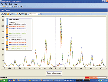

  • Improved detectability: Overlay of scans allows improved analysis and earlier detection of defects.

 Fig.11. Overlay feature in the Teletest Software allows changes to be detected earlier
