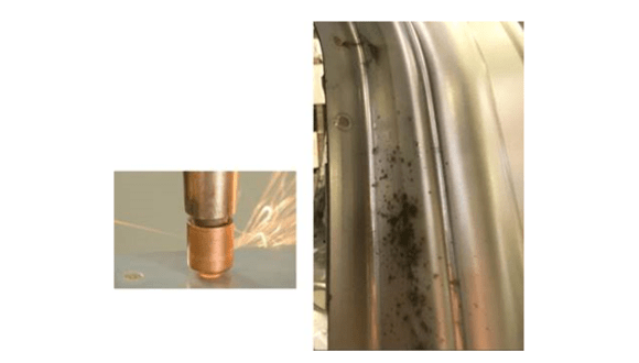

TWI were involved in supporting BMW Mini Plant Oxford in reducing instances of weld expulsion during resistance spot welding processes used for Mini bodies. Each of these vehicles contains over 6000 resistance spot welds that can potentially be subject to weld expulsion, which is when a physical instability in the welding process causes the ejection of liquid metal from the weld. While this expulsion is not often related to the production of a defective weld, manual identification and cleaning is required. The expelled metal can damage paintwork and initiate later corrosion failure leading to costs not only related to personnel being employed to rectify expulsion damage but also in corrosion warrantee claims.
Data collection at BMW is able to identify when and where expulsion occurs on the 1000+ robot production line, but not the reason why. It was important to determine the cause of expulsion in each individual case order to take steps to prevent it.
Figure 1. Weld expulsion and visible damage to the vehicle body panels resulting from expulsion
