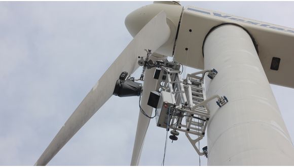

The project has developed a robotically-deployed system for in-situ WTB inspections, which combines robotics and shearography to deliver a more efficient, accurate and safer inspection method compared to current state-of-the-art techniques.
Figure 1. SheaRIOS robotic crawler deployed on a WTB at the Centre for Renewable Energy Sources (CRES)

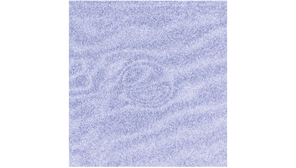

The on-site trials successfully saw the robotic climber scale the wind turbine tower and deploy a crawler robot onto a WTB. The crawler manoeuvred across the blade to an area of interest that was inspected by the on-board shearography equipment. Further tests using a defect sample carried by the crawling robot were successfully performed.
Figure 3. Shearography fringe pattern obtained with the SheaRIOS inspection system
