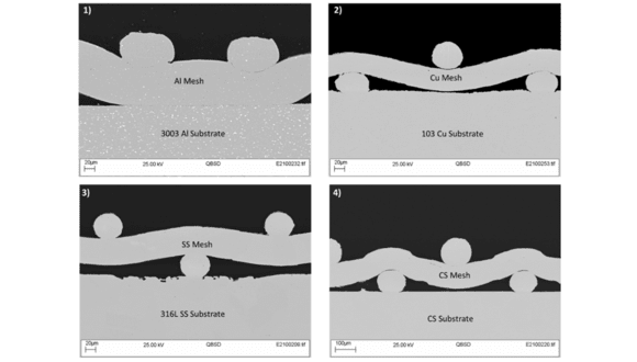

In this study, a hierarchical mesh-covered (hi-mesh) surface was successfully developed using uniaxial diffusion bonding (UDB) process to enable sucking flow condensation for expediting both droplet growth and surface refreshing. Commercially available woven micro meshes of pure copper, aluminium, mild steel and 316 stainless steel were metallurgically joined on top of copper C103, aluminium 3003, carbon steel (CS) P355NH and 316 stainless steel (SS) substrates, respectively. Prior to UDB, both the substrates and wire mesh surfaces were cleaned to remove the native oxide layer. Various UDB trials were performed with different diffusion bonding process setup and parameters, such as stacking conditions, temperature, pressure and time to optimise the interfacial adhesion between substrate and respective wire mesh.
All samples showed good metallurgical bonding with plenty of interconnected channels to help liquid condensate flow passages between substrate and hi-mesh. Further, these samples were coated with three different commercially obtained hydrophobic coatings with two different kinds of SiO2 nanoparticles. Hi-mesh bonded superhydrophobic surfaces will be tested in GeoHex test rigs to examine their performance in more representative environment.

Optical image of the cross-sectioned part of the 1) Al woven hi-mesh to 3003 Al substrate 2) Cu woven hi-mesh on 103 Cu substrate, 3) 316L SS hi-mesh woven hi-mesh on 316L SS substrate and 4) Mild steel woven hi-mesh on P355NH CS substrate.
