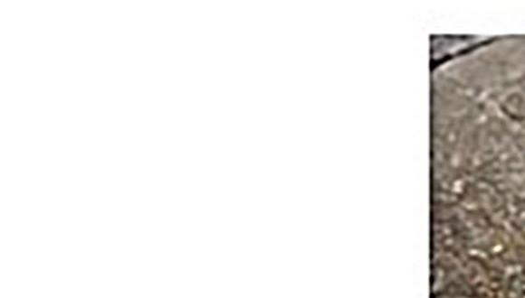

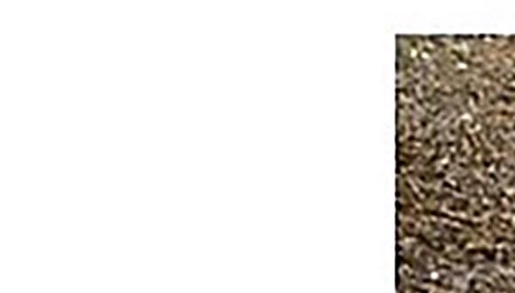

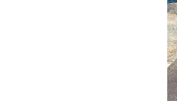

According to the CVI report, the depth of external corrosion in the ring groove is in the range of 0.2 to 0.4 mm. (as shown in Figures 5 & 6).
Figure 5 - General photo of external corrosion in the ring groove
Figure 6 - General photo of external corrosion in the ring groove

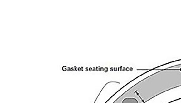

According to ASME PCC-1, APPENDIX D, Section D-2, the type of gasket should be considered to evaluate the imperfection of the flange surface. There are two different types of gasket.
  • Hard-faced gaskets (Ring gasket)
  • Soft-faced gaskets
The gasket discussed in this issue is a hard-faced gasket (ring gasket). The following Three main parameters should be measured to assess the corrosion in flange faces:
  • Radial width of gasket seating surface (This parameter is denoted by "w" in ASME PCC-1.). (As shown in Figure 7).
  • Projected radial distance across the seating surface (This parameter is denoted by "rd" in ASME PCC-1.). (As shown in Figure 7).
  • Radial measurement between defects (This parameter is denoted by "d" in ASME PCC-1.). (As shown in Figure 7).
Figure 7 - Flange surface damage assessment (Pits and dents). (Reference: ASME PCCC-1)

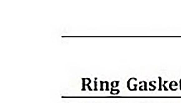

According to the ASME B16.20, table RJ-3.2-1, a new ring (Gasket ring) should be prepared according to the part specified (Red mark part) in the following table:
Table 4 - Maximum hardness for ring gasket. (Reference: ASME B16.20)
Considering the galvanic series (Table 2), there is no significant potential difference between the suggested ring gasket in the aforementioned table and the mating flange, therefore, there is no probability of galvanic corrosion between the ring gasket and ring groove.
