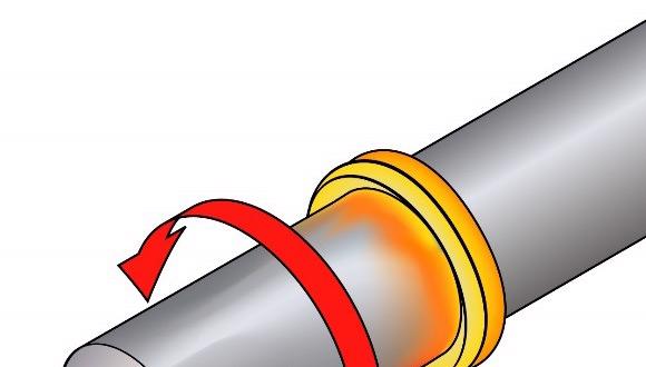

RFW is a solid-state welding technique where two parts, in this case the pipe and the tool joint, are forged together using mechanical motion and heat generated by friction. One part is rotated while the other remains stationary and an axial force is applied between the two parts. RFW is the preferred joining method for drill pipes and other critical applications due to the advantages it displays in comparison to fusion welding techniques. The process has lower peak temperatures than fusion welding, reducing intermetallic formation and allowing for a range of dissimilar materials to be joined. The process is easily automated, and therefore highly repeatable. Defects associated with melting and solidification are avoided and the resulting microstructure often displays higher strength than the starting base material.

Schematic of rotary friction welding process
