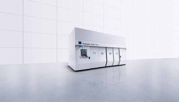

TWI Ltd has ordered a TRUMPF TruLaser Cell 7040 five-axis machine with a disk laser and laser metal deposition (LMD) functionality.

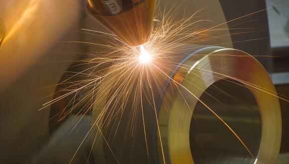

The LMD process uses a focussed laser beam and metal powders to add weld material onto a substrate. Through multiple layering techniques, a coating or 3D geometry can be deposited to replace damaged features or to manufacture entirely new geometries. The advantages of the process include a high integrity fusion bond between the deposited material and the substrate, and a very low heat input from the laser beam into the base material, which produces a small heat affected zone and accurate and reproducible positioning. TRUMPF customers benefit from a wide range of lasers and laser systems, process expertise, and services for numerous applications, which means LMD technology can also be combined with laser welding or laser cutting. This is indeed the case with the TruLaser Cell 7040 where, thanks to inherent modularity, users can change easily between cutting, welding and LMD.

The TruLaser Cell 7040 features several important modifications that make it unique in the marketplace. Importantly, TRUMPF and TWI are working in close co-operation to deliver a system that will meet specific requirements of the OAAM project. This work has led to the specification of a number of critical adjustments to the standard system. For instance, the 1m Z-axis capacity will be extended to 1.5m in order to accommodate large aerospace parts; coupled with a 4m x 2m capacity X-axis and Y-axis. In addition to the machine’s five-axis capability, there will be a fully integrated rotate and tilt table with a 1500kg load capacity, controlled by special software routines specified by TWI and being developed by TRUMPF. This will be further supported by Autodesk, who are developing common CAD/CAM control interfacing across the OAAM DED technologies. The modularity of the TruLaser Cell will also enable TWI to integrate additional process steps (e.g. non-destructive inspection systems) for optimum implementation to aerospace requirements.

Application of wear resistant coatings using the LMD process
Trumpf 3D laser system
