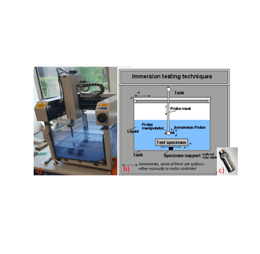

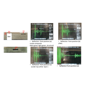

- Non-Destructive Evaluation of Sandwich Composite Structures
As interest grew across industry in the use of sandwich composite structures, there grew a need to find a reliable non-destructive inspection solution. These structures posed an inspection challenge as the energy that is applied for the inspection is highly attenuated due to absorption and scattering, causing difficulties in the interpretation of received energy and sizing. Ultrasonic testing techniques were tested on artificially-induced flaws in a composite structure (Figure 2). The inspection was performed underwater in an ultrasonic immersion tank (Figure 3) with the ultrasonic wave generated by a probe passing through the water to propagate inside the specimen. Any obstacles inside the specimen reflected the wave. Analysis of these reflected waves allowed for a 2-dimensional image of the reflections (called a C-scan) to be created (Figure 4) while a flaw detector allowed for the detection of the flaws (Figure 5). This project showed that sandwich composite structures with glass fibres can be successfully inspected using ultrasonic techniques.

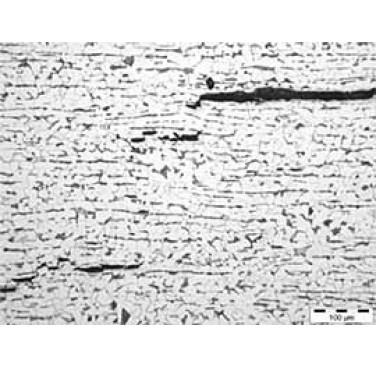

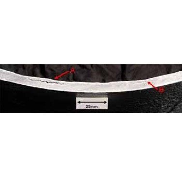

- Fitness-for-Service Project on Middle Eastern Pipeline
Kuwait Oil Company (KOC) contacted us following the discovery of internal blistering on a 20” diameter cross-country pipeline. As well as undertaking a fitness for service assessment based on the damage that was present, KOC also sought advice on future pipeline operation and integrity management. TWI was sent a 200mm long specimen of the longitudinally welded pipe for analysis, along with an undamaged sample of spirally welded pipe from the same pipeline for comparison purposes. We conducted both destructive and non-destructive testing, including manual ultrasonic testing, to identify the material’s properties, identify the damage mechanisms, and characterise the extent of the damage (Figures 6-7). The results of these tests, as well as in-line inspection (pigging) undertaken by KOC, we were able to draw conclusions about the fitness for purpose of the entire pipeline and provide recommendations for future operation, inspection and integrity management. Our expertise in inspection, testing, fitness for service assessment, and pipeline integrity management were combined to enable KOC to make significant savings on inspection and repair works, while demonstrating the safety and integrity of the pipeline.

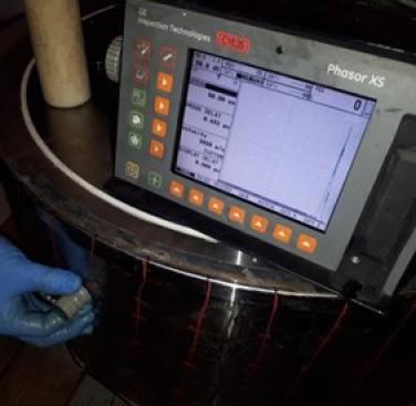

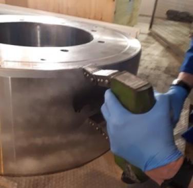

- NDT Inspection on a Mechanical System Component
TWI was contacted by an Industrial Member company requiring non-destructive testing of a component within a mechanical system on-site at their facility in France. Our technicians were despatched to ensure that the component was free from defects or damage after it suffered a handling incident during transportation. The TWI team undertook magnetic particle inspection, phased array ultrasonic testing and manual ultrasonic testing. This combination of NDT methods provided confidence by confirming that there were no defects within the component, enabling it to be used as originally intended.

Figure 3. Immersion set up. A: system applied. B: principles of usage. C. 5MHz immersion probe selected

Figure 5. A-scan results from the flaw detector
Figure 6. Magnetic particle inspection of the pipeline sample examined by TWI, showing internal blistering (A) and hydrogen induced cracking (B)
Figure 7. Hydrogen induced cracking viewed under optical microscopy. The image shows a microstructure containing a significant number of laminar inclusions which act as nucleation sites for HIC. Distortion of the microstructure caused by the cracking can be seen, along with step-wise crack growth, which is characteristic of HIC
Figure 8. The set-up for UT inspection
Figure 9. The set-up for MPI inspection
