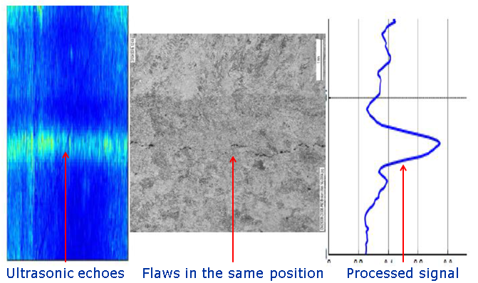

Verification of signals against sectioning of specimens with creep damage
The ultrasonic technique
CreepTest developed an ultrasonic technique using physical principles and simulations. Specimens were generated in TWI and trials were held on service-exposed components supplied by consortium partner SSE. The validation was completed by sectioning specimens to confirm the presence of early-stage creep voids.

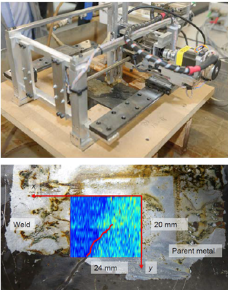

Prototype for field inspection
The technique was encapsulated in a prototype system for field implementation in operating power plants. Its effectiveness was confirmed by additional testing on power plant components.

Prototype scanner designed for inspecting field exposed component in-situ (top) and superimposition of scan data over area ahead of a crack-top with creep damage
