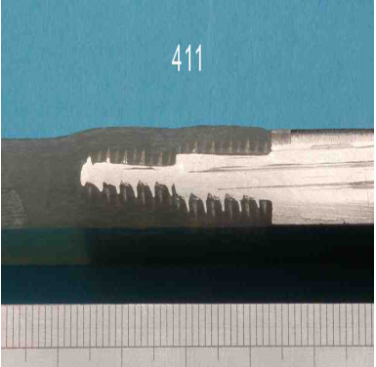

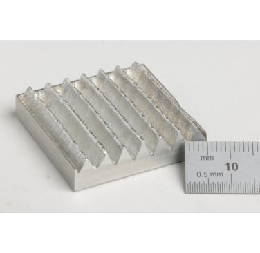

By 2018, our experts had returned to the topic of electron beam Surfi-Sculpt for a new CRP. TWI used slow motion analysis to provide a greater understanding of the process (Figures 1-2). This highlighted four distinct phases for the formation of a Surfi-Sculpt feature as well as showing that the initial movement of molten material caused by interaction with the beam is more controlled using electron beams than when using lasers. Heat exchanger testing with the use of Surfi-Sculpt showed an approximate doubling of the heat transfer coefficient when compared to a conventional design at a similar pressure drop and a 1000w heat load. Surfi-Sculpt was also able to maintain the operating temperature of a power resistor 30 degrees lower than with a conventional design. The process was also assessed in relation to composite to metal joining to improve lay up and ensure no voids are left.

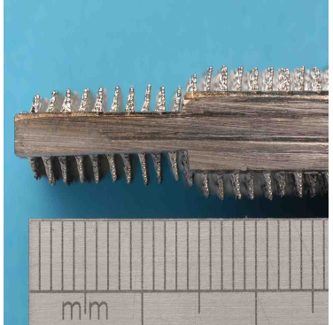

This work sought to provide improved composite-to-metal joining so that the high strength and low weight benefits of fibre reinforced polymers could be better realised when joined to metals. Poor mechanical performance, low fatigue resistance, and a distrust of repeatability and joint integrity had created an atmosphere of over-conservatism in the use of composite-to-metal joins, which was negating many of the benefits of the materials.

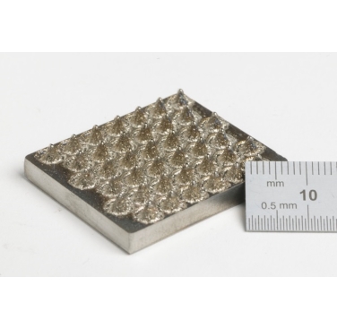

The use of Surfi-Sculpt as a metal pre-treatment process (Figure 3) to create an improved bond between the polyester resin and the prepared surface (Figure 4). This process, dubbed ComeldTM, led to joints failing at much higher loads and with the absorbing of far more energy before failure than with a conventional joint of identical dimensions.

Figure 1. Cone shaped features on 5mm Ti-6Al-4V substrate
Figure 2. Ridge features on 6mm Al6082-T6 substrate
Figure 3. The pretreated metal
Figure 4. A Comeld joint
