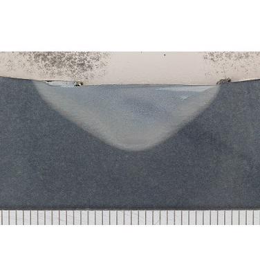

Modern Pipeline Inspection Gauge (PIG) systems are capable of detecting the onset of corrosion and monitoring its spread, providing valuable data on the location and potential consequences of the problem. However, once the presence of a defect is known, there is a requirement on the operator to assess and mitigate against any effects it may have. Existing means of dealing with a corrosion or similar small defects are complex, or expensive, or difficult to deploy, or all of the foregoing, and usually require significant time to implement. TWI Yorkshire’s Friction and Forge Processes section were thus tasked with developing a friction stir welding technique that can be deployed on a specialised PIG to perform a patch repair inside a 36” diameter, sub-sea, steel pipe, with the oil still flowing.
Making a friction stir weld requires, as the name suggests, plenty of friction – a commodity in short supply when the area of the steel pipe being welded, and the friction stir welding tool doing the repair weld, are both immersed in oil! Excluding the oil from the region of the pipe being welded not only proved impractical, but would also have introduced a further problem, namely a potential for fire or explosion due to the presence of residual hydrocarbon vapours. It was therefore necessary for TWI to overcome the issues arising from making a friction stir weld in a very lubricating environment, and to develop the necessary welding control parameters that would allow the process to be performed autonomously, in complete darkness, up to 200 miles offshore…
TWI’s Materials Performance and Ferrous Alloys section assisted by assessing samples of the welds made to confirm that the new FSW process parameters had not only produced a sound weld but, equally importantly, had not caused an uptake of hydrocarbons into the weld zone. This was shown to be the case. Further work will be performed by TWI’s NDT Validation Centre, to assist in developing the on-board weld validation system that the PIG will also carry.

Figure 1. Section through an 8mm deep friction stir weld made into a 28mm wall thickness, API-X65 steel pipe. The weld was performed under oil and is defect free
