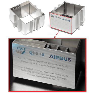

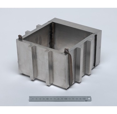

Figure 1. LFW PMD Box technology demonstrator as welded
Figure 2. LFW PMD Box technology
 demonstrator. The engraved text reads:
“Near-Net-Shape Propellant Management Device Manufactured by Linear Friction Welding. General Support Technology Programme funded by ESA. Designed by Airbus Defence and Space, Stevenage. Prototype Manufactured by TWI Ltd.”
Figure 2. LFW PMD Box technology demonstrator. The engraved text reads: “Near-Net-Shape Propellant Management Device Manufactured by Linear Friction Welding. General Support Technology Programme funded by ESA. Designed by Airbus Defence and Space, Stevenage. Prototype Manufactured by TWI Ltd.”
