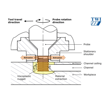

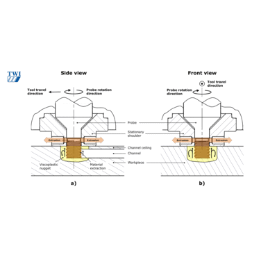

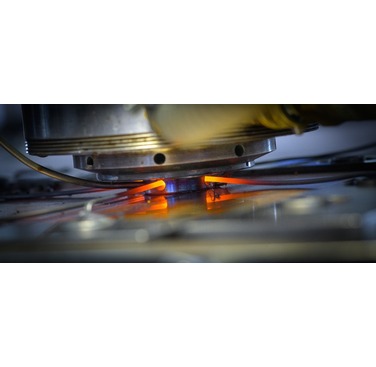

TWI invented and patented a stationary shoulder variant of friction stir channelling (SS-FSC), which has subsequently been trademarked as CoreFlow®, and is a derivative technology of friction stir welding (FSW), a joining process invented at TWI in 1991. As shown in Figures 1 and 2, a stationary shoulder is employed to confine the viscoplastic nugget, limiting the flow of material extracted by the probe and preserving enough material to consolidate a roof over the channel. Therefore, an enclosed liquid cooling channel can be created in metallic material, such as aluminium or copper, in a single step.

Figure 1. SS-FSC technology developed by TWI, trademarked as CoreFlow® (a) Cross-section view perpendicular to tool traverse b) View of tool towards the reader

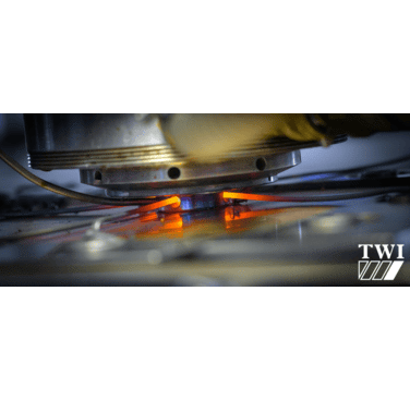

Figure 2. CoreFlow® friction stir channelling of copper in action

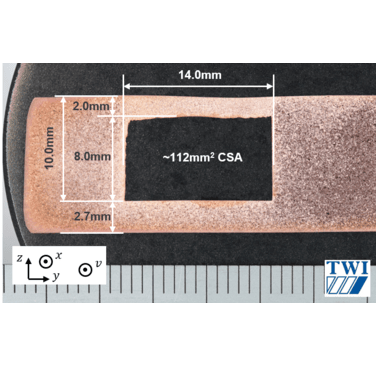

The targeted channel cross-sectional area based on current “first wall” component design was 95mm2. Due to the aspect ratio currently used for CoreFlow® process probes, it was decided that a 14mm-diameter probe which was plunged 10mm-deep into the material could produce the targeted channel cross-sectional area with the development of suitable process parameters. A 14mm-diameter probe is expected to produce a 14mm-wide channel; therefore, a channel height of around 6.8mm would produce a channel with an approximate 95mm2 cross-sectional area.

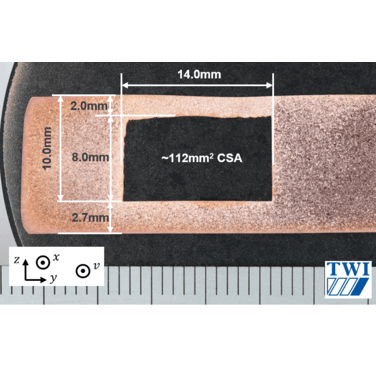

A series of parameter development trials were conducted to optimise the channel cross-section and assess consistency and repeatability. As a result, preliminary process parameters were capable of repeatedly producing a relatively rectangular channel cross-section, which is approximately 14mm-wide and 8mm-tall, with a 2mm-thick channel ceiling across the top, yielding a cross-sectional area of around 112mm2, as shown in Figure 3.

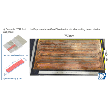

Once suitable parameters were identified from the parameter development trials, the next focus was on achieving longer channel lengths that sustained suitable channel consistency. This culminated in the successful production of two serpentine channels within a 750x350mm plate, with each channel being over 2,500mm-long, as shown in Figure 4. This demonstrator proves the scale required for fusion industry applications is achievable and significantly de-risks further development.

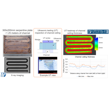

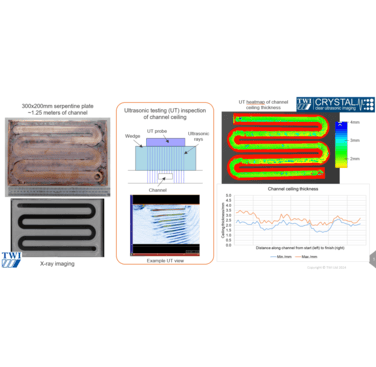

Using TWI’s Crystal™ software, a non-destructive testing (NDT) procedure was developed which utilised ultrasonic testing (UT) to provide a quantitative measurement of channel ceiling thickness. The colour-coded heatmap in Figure 5 can be used to quantitatively assess the consistency of channel ceiling thickness along the length of the channel.

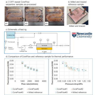

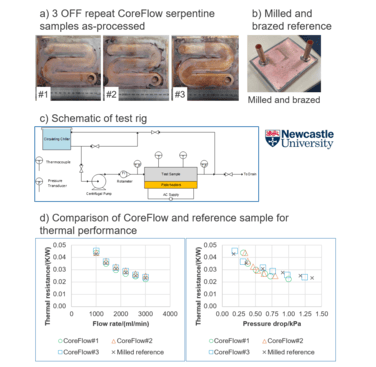

Thermal testing was conducted by Newcastle University and assessed the thermal resistance performance of CoreFlow® samples versus a milled and brazed reference sample. As shown in Figure 6, there is very close agreement between the CoreFlow® samples and the reference sample, with no significant difference in thermal resistance. These results therefore demonstrate that there is not an expected performance detriment by using a cooling plate manufactured via CoreFlow®. This is alongside the potential benefits of utilising the CoreFlow® for manufacture, which includes lower manufacturing costs, quicker qualification, and improved channel path and overall component geometry.

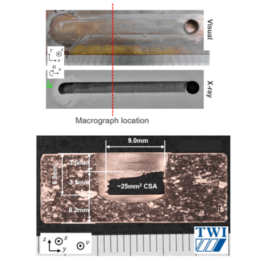

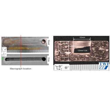

Following the success with developing process parameters in copper, early-stage viability was proven in Copper Chromium Zirconium (CuCrZr), which is a fusion industry relevant copper alloy. Figure 7 details an example channel cross-section with this work progressing to successfully produce repeated serpentine samples. This achievement significantly de-risks future development, which will focus on further maturing the process in CuCrZr copper alloy.

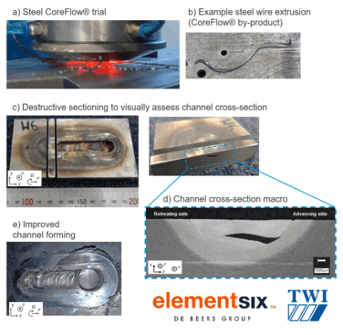

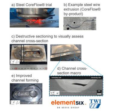

It was previously unknown whether the CoreFlow® process fundamentals could be proven in steel, due to the harsh process environment and different material properties when compared with aluminium and copper. TWI collaborated with Element Six to procure preliminary toolsets to use for feasibility assessment trials. As demonstrated in Figure 8, the CoreFlow® process fundamentals were proven in the feasibility trials conducted. The rotating tool was capable of generating sufficient heating in the steel material to draw up and extrude steel wire whilst leaving behind an enclosed channel. These results de-risk future development and have identified the key focus areas as tool material development and tool design optimisation.

Figure 3. Channel cross-section example in copper
Figure 4. CoreFlow® friction stir channelling demonstrator aligned to current fusion reactor design

Figure 5. Development of ultrasonic testing (UT) for non-destructive examination (NDE) to quantify channel ceiling consistency using TWI’s Crystal™ software
Figure 6. Summary of thermal testing performed by Newcastle University
Figure 7. Channel cross-section example in CuCrZr copper alloy
Figure 8. Summary of feasibility trials in steel
