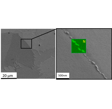

Figure 1. Chromium (II) nitrides at the ferrite-to-ferrite phase boundaries.  Overlapped, nitrogen elemental mapping with windowless EDX

  • Chromium nitrides were found in ferrite in the simulated high temperature, heat affected zones (Figure 1), although their appearance is normally associated with faster cooling rates, i.e. low heat input and reduced austenite content. Despite the advantage of a coarse austenite morphology, the improved properties may be compromised by Cr2N, potentially offsetting any benefit.

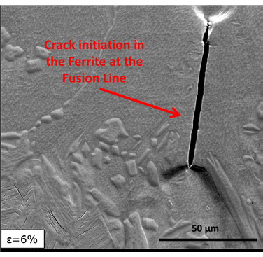

  • HISC in DSS heat affected zones is strongly influenced by the ferrite morphology, with intragranular and grain boundary austenite offering limited HISC resistance (Figure 2).
  • Coarser austenite grains are beneficial for HISC resistance, but austenite can also become embrittled by high concentrations of hydrogen, e.g. in environments in which hydrogen recombination poisons are present and/or high charging currents are employed.

Figure 2. Quasi-in-situ scanning electron microscopy straining of specimen taken form a TIG welded pipe.  Detail of the heat affected zone with crack nucleation at 6% strain
