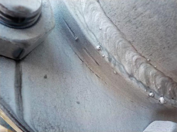

Figure 1. A defect found at the fillet radius of a flange

During an inspection of a refrigeration system operated by a TWI Industrial Member company, some crack-like defects were found at the fillet radius of the flanges (Figure 1) which were made of steels in compliance with ASTM standard. TWI was awarded a project to carry out ECA in order to determine the maximum tolerable defect size for each flange for the design life.
As no fracture toughness or even Cv values were available, the initial assessments were based on the fracture toughness values estimated from the specified minimum Cv value for the steel, as specified in the relevant standard, i.e. 27J at 20oC. The maximum tolerable flaw size determined was less than some of the defects found.
Subsequent Charpy testing of the steel did not produce a significant increase in the estimated fracture toughness. Finally, fracture toughness testing at the appropriate temperature was performed to directly obtain the fracture toughness values.
Project outcomes
The fracture toughness values of the steel in several different size of flanges were obtained from crack tip opening displacement (CTOD) testing at the anticipated service temperature of -20oC.
The exercise showed that they were all significantly greater than those estimated from the Cv values, by factors more than 2.6. As a result, the maximum tolerable flaw sizes, assessed using the experimentally determined fracture toughness values, significantly increased. Therefore, all the defects found were acceptable and there was no need to replace these flanges. This has avoided downtime of the system and also reduced cost.
