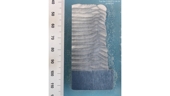

TWI has developed an approach to evaluate the additive manufacturing (AM) of magnesium for industrial end-users.
TWI Project leaders, Nicolas Pembrey and Lei Xu assessed both thick and thin AM components of varying shapes made from magnesium. The parts were designed to represent common industry applications and were found to show no visible porosity, lack of fusion or other defects.
Having provided this initial demonstration of process feasibility, future work will now focus on further process development and the creation of parts with more complicated geometries.
