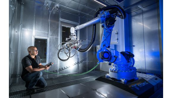

We are pleased to announce the installation of a new Titomic Kinetic Fusion (TKF) cold spray machine at TWI Cambridge.
The TKF 1000 uses cold spray, also known as supersonic metal powder deposition, to create industrial-scale parts and complex surface coatings. Using TKF technology, co-developed by Titomic and Australia’s national science agency and innovation catalyst, CSIRO, the TKF 1000 uses a patented process for the application of cold-gas dynamic spraying of titanium or titanium alloy particles onto a scaffold to produce a load-bearing structure.
TKF accelerates metal particles to supersonic speeds by injecting them into a jetstream, which sprays the particles from a nozzle to collide and stick with a surface (and each other) through plastic deformation. This particle build-up rapidly produces near-net-shape metal parts. TKF can increase productivity, lower costs, and reduce waste by 80% compared to traditional machining.
TKF 1000
The TKF 1000 at TWI is able to support a range of low to mid-size production applications with its off-the-shelf, turnkey additive manufacturing system offering rapid and agile manufacturing, prototyping, custom parts, and pilot runs prior to mass production.
The TKF 1000 can be used with a wide range of metals and alloys including titanium, steel, copper, nickel and magnesium. Because the system can fuse dissimilar metals, it can be used to create composites metal items that exploit the strengths of multiple metals in a single part.
System Features:
  • 6 axis robotic manoeuvrability
  • Rapid deposition rates
  • Protective, sound-dampening booth
  • Integrated dust extraction
Specifications:
  • Build envelope: 1m x 1m x 1m
  • Footprint: 6.5m x 4.3m x 3m
  • Shuttle load: 1000kg
