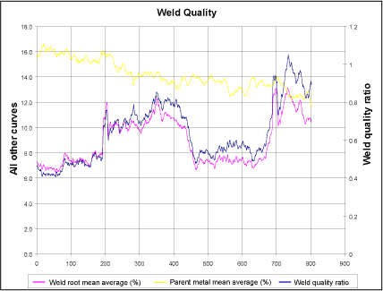

To provide a quantitative inspection method, a stable measure of the mean noise level within the weld root was required. Initially the ratio of weld root noise to weld nugget noise was studied and reported [2] . From further study, the ratio of the parent plate noise to the weld root noise was chosen as the most stable measure, this ratio normalising all the inspection parameters to that of the parent plate material noise. The statistical results from the Qualistir trials are discussed in Ref. [3] showing a stable method for both 7075 and 2219 butt welds. To apply this basic method to a production situation a semi automated quantitative method was required for the sentencing of the data.
Figure 9 provides a sectional view through the ultrasonic data showing two boxes, M1 and M2, these illustrate where the ultrasonic data was extracted for analysis. Figure 11 illustrates the plan view of the data extraction boxes in yellow. The data within these boxes is analysed for back-scatter noise amplitude. FSW produces relatively large changes in microstructure with respect to axial position along the weld further the parent plate showed ultrasonic back scatter noise variations with respect to plate axial position. The plate grain structure variations are caused by the change in either roller, die or material temperature when initially rolled or extruded. The signal amplitude changes due to the JLR are small hence the variation in material properties with respect to axial position prevented a simple threshold being placed on the weld root noise or even a single sample point for the parent plate noise. Because FSW is a machine process if an out of control welding parameter develops, it is likely to be relatively long (>5mm). This feature provided the opportunity to perform statistical processing to stabilise the small variations in noise ratio due to the local grain structure changes providing a stable measurement of quality. An algorithm was developed which imports 3D volumes of data out of the raw inspection data from the specified areas within the weld and parent plate. It then performs a volumetric moving average type function to smooth out the individual noise amplitude values. This method also minimises the effect of spurious indications in the scan data, which generally appear singularly and not in clusters. The algorithm then compares the manipulated noise data of the weld root with that of the parent plate. The ratio of the two isa quantitative indicator of the weld quality.
Figure 12 shows a graph of the back-scattered noise data collected from a weld with no JLR or natural defects. The yellow line provides the moving average ultrasonic back scattered amplitude of the weld root, the red line the parent plate and the black line the noise ratio/ weld quality number. It can be seen that the noise ratio achieved in the weld root, was about 0.5. A noise ratio of 0.5 means that the noise of the weld root is half that of the parent plate, whereas at 230mm along the weld where a 0.2mm spark eroded notch had been machined the noise ratio is 1.2. A noise ration of 1 indicates no root forging i.e. the weld root has the same grain structure as the parent plate, and the likely presence of JLR or LOP. Figure 13 shows a back scattered noise graph from a weld with 1.0mm JLR but with no LOP. Here the noise ratio lies almost entirely over the value of 1, detecting a high noise level at the weld root and indicating an incorrectly forged nugget.

The development work has concentrated on an in-line method for providing data as part of the overall quality control process for FSW The developed inspection and data analysis method can clearly and precisely detect conventional defects, e.g. voids and LOP, with a through wall height of 0.1mm with a good signal-to-noise ratio. Conventional data analysis uses signal amplitude, as a defect discriminator. FSW can, if not correctly controlled, have serious defects with signal amplitudes smaller than that of the TMAZ.

The system was demonstrated both at TWI and at GKSS in both cases the welds contained a mixture of good regions and deliberate defects. Figure 16 shows the noise ratio graph of the flat bed weld generated for this demonstration. This weld had four zones; the first zone from 0 to 200mm was a fully penetrated region with no JLR. This zone has a noise ratio of0.4 to 0.5; the second zone from 200mm to 450mm has a JLR 0.7mm deep with a noise ratio of 0.6 to 0.8; the third zone again was a good region; the fourth zone again had a JLR/LOP to a depth of 1mm with the noise ratio of 0.7 to 1.0.Themacrographs of regions one and two are shown in Fig.17 and 18 and plan view of the ultrasonic data is shown in Fig.19. The ultrasonic image is from the root of the weld and clearly shows the four weld zones.

Fig.19. Pan view of ultrasonic data showing the four weld zones and the differing noise levels
The second demonstration was at GKSS. Again the weld was a butt weld in Al 7075 but this time the weld was curved and the NDT head was scanned over the weld by a robot arm. The noise ratio graph is given in Fig.20 and a plan view of the ultrasonic data is given in Fig.21. From the graph it can be seen that the beginning and end of the weld has noise ratio exceeding 0.7 whilst the central portion has a noise ratio of about 0.5. The central portion of the weld was defect free and the ends had a mixture of defects. Where the noise ratio exceeded 1.2 the welds contained LOP and lack of fusion defects due to tool miss-alignment.
Fig.20. Graph of noise ratio with respect to axial position for GKSS weld showing defective areas at the beginning and end of weld
