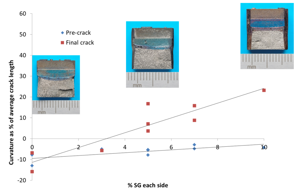

The intention of side-grooving is to ensure straight stable tearing propagation, so it was also necessary to quantify the shape of the stable tearing on the fracture faces from these tests. As a consequence of side-grooving, the original fatigue pre-crack shape is sometimes improved in terms of crack curvature as well, by machining away the most curved part of the pre-crack at the outer surfaces.
To evaluate the effect of side grooves on the pre-crack straightness, and the straightness of the stable tearing in the specimen, the nine crack length measurements made across the crack front were used to determine the average initial precrack length, a0, [25]. The final crack length after tearing, af, was determined in the same way. None of the nine individual measurements of SENT pre-crack length should differ from the average by more than 20% of the average [20]. Likewise, the difference between the average final crack length measurements at any of the nine points was compared to a target difference of no more than 20% of the average.
In this analysis, instead of simply quoting the magnitude of the difference between the average and the maximum or minimum, it was recorded whether the largest difference was positive or negative. The greatest deviation from the average crack length is usually the measurement closest to the outside surfaces of the specimen, furthest from the centre of the pre-crack. If the largest deviation from the average pre-crack length is negative, it suggests that the edges of the pre-crack bow back behind the pre-crack. If the largest deviation is positive, it suggests that the pre-crack shape is re-curved and that the outer edges of the pre-crack are ahead of the average crack length. By keeping the positive or negative sign associated with the deviation in crack measurements from the average, this provides some information about the crack shape which could be also plotted against the depth of the side groove each side to determine whether there was a correlation. This is shown in Figure 10 for surface notched specimens and Figure 11 for through-thickness notched specimens.
Figure 10 The deviation of the maximum crack measurement across the crack front from the average (the crack curvature) expressed as a percentage of the average crack length, for the fatigue pre-crack and the final crack including stable tearing, for
Figure 10 The deviation of the maximum crack measurement across the crack front from the average (the crack curvature) expressed as a percentage of the average crack length, for the fatigue pre-crack and the final crack including stable tearing, for surface notched specimens.
For the initial crack precrack shape, the difference between the average and minimum/maximum values was consistently negative (backward bowing), and showed a weak improvement with side groove depth. The precracking is performed before side grooving, so deeper side grooves machine off more of the most backward curving part of the precrack at the outer surfaces, making the shape of the remaining precrack as being measured straighter.
For the final tearing crack shape, the difference between the average and minimum/maximum values of was strongly affected by the depth of the side grooves for both surface and through-thickness notched specimens. Without side grooving the difference was negative, similar to the precrack difference. However, by 3% side grooving some values were positive and some negative (depending on notch orientation), and at 5% and above the difference was positive, increasing with side groove depth. Based on the correlations in Figures 10 and 11, the difference exceeded the target of 20% at a side groove depth of 7%, although some 5% side grooved specimens were beyond the 20% limit as well.
The experimental results from this work confirm the recommendation that the side groove depth for SENT specimens should be 5% each side when generating unloading compliance R-curves.
Figure 11 The deviation of the maximum crack measurement across the crack front from the average (the crack curvature) expressed as a percentage of the average crack length, for the fatigue pre-crack and the final crack including stable tearing, for
Figure 11 The deviation of the maximum crack measurement across the crack front from the average (the crack curvature) expressed as a percentage of the average crack length, for the fatigue pre-crack and the final crack including stable tearing, for through-thickness notched specimens.
