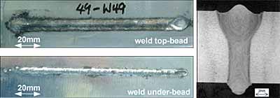

Hybrid laser-MIG welding was carried out in the PF welding position and arc pushing configuration, the MIG arc trailing 2mm behind the laser beam, at a travel angle of 30° with the laser axis, Figure 1, using 7kW of Yb-fibre laser power focused on the material surface, 6m/min wire feed speed and helium shielding through the MIG torch. For a laser spot size of 0.4mm and 0.6mm, the maximum welding speed for full penetration was 0.92m/min and 0.94m/min, respectively. For both spot sizes, a welding speed as low as 0.5m/min, as achieved for the autogenous laser welding trials, still resulted in full penetration with an acceptable weld-bead appearance. The weld bead appearance of all hybrid laser-MIG welds displayed a regular surface ripple, with the cross-section and weld-bead appearances of a typical weld produced using a 0.6mm spot size at the maximum welding speed for full penetration shown in Figure 4.
Fig.4. Top and bottom weld bead appearance and cross-section of a fully penetrated hybrid laser-MIG melt run produced in 12.7mm 7xxx aluminium alloy in the PF welding position at the maximum welding speed of0.94m/min

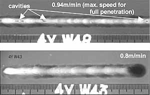

Cavities and coarse porosity
Removing the high melting-temperature, tenacious oxide from the top and bottom surface of the 7xxx aluminium alloy, as well as from the edges to be welded, by dry-machining (as used here) just prior to welding, reduced the number of cavities and coarse pores. However, removing the oxide alone was not sufficient to produce cavity-free laser welds. When the oxide layer is thick and not removed prior to welding, the evaporating alloying elements can form high meltingpoint metal oxides during laser welding. These change the molten material viscosity, which impacts on the keyhole stability, and may also form a tenacious skin on the weld pool surface, which impedes the escape of formed pores. [9]
Keyhole instabilities in aluminium laser welds are often associated with the presence of low boiling point constituents, such as Mg and Zn, and the (violent) evaporation thereof during laser welding. To test this theory, fully penetrating welds were produced in 12.7mm thickness 2024 aluminium, another alloy frequently used in the aerospace industry, using identical welding conditions as those used for the 7xxx alloy. However, despite lower levels of both Mgand Zn in the 2024 alloy, the laser welds contained a larger level of cavities and coarse porosity compared with those produced in the 7xxx aluminium alloy. The other, most commonly accepted theory for keyhole instability is related to the viscosity/fluidity of the weld pool forming behind the keyhole, which can cause the top of the keyhole to collapse. Silicon (Si), for instance, makes the weld pool more fluid, [10-11] and the higher Si-content in the 2024 alloy compared with the 7xxx alloy, ie 0.5% compared with 0.1%, may explain why a higher number of keyhole-related pores were observed in the 2024 melt runs.
The hybrid laser-MIG process was also capable of reducing, but not eliminating, the occurrence of cavities and the number and size of coarse pores, compared with autogenous laser, when welding 12.7mm thickness 7xxx aluminium, as shown in Figure 5. A less vigorous weld pool motion was evident from the small surface ripple observed on both the top and under-bead of the hybrid laser-MIG welds, Figure 4 (produced at the maximum speed for full penetration) compared with the autogenous laser welds, Figure 2 (produced at the minimum speed for full penetration). This was the result of the MIG arc enlarging the weld pool at the top of the keyhole, dampening the weld pool motion, and thereby reducing the occurrence of keyhole instabilities and producing a more uniform weld bead profile, compared with autogenous laser.
Fig.5. Full penetration melt runs in 12.7mm thickness 7xxx aluminium produced using the autogenous laser and hybrid laser-MIG process produced at a welding speed of 0.65m/min

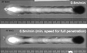

A laser spot size of 0.6mm produced less cavities than a 0.4mm spot size when laser welding the 12.7mm thickness 7xxx aluminium. Equilibrium between pressure from vaporisation and from surface tension of the molten material is required for a stable keyhole, with the latter working to close the keyhole formed by the evaporation of the material. [12] A smaller spot size produces a higher surface tension, because of the smaller radius of the keyhole walls, [12] resulting in a keyhole that is more prone to collapse. [7] Moreover, the smaller the keyhole, the easier it is for the front, back and sidewalls of the keyhole to touch, and collapse.
Of those investigated, the factor that had the largest effect on the occurrence of cavities and coarse porosity in laser-welded 12.7mm thickness 7xxx aluminium, was welding speed. The influence of welding speed on the occurrence of cavities is shown in Figure 6. Using a 0.6mm diameter spot size, full penetration could be achieved at a welding speed of 0.65m/min and 0.94m/min for autogenous laser and hybrid laser-MIG welding, respectively. However, welds produced at these maximum speeds (for full penetration) contained cavities. When slowing down (whilst maintaining full penetration), less cavities were observed, due to the molten pool behind the laser keyhole getting larger, thereby dampening the weldpool motion and stabilising the keyhole. At welding speeds equal to or lower than 0.55m/min and 0.75m/min for autogenous and hybrid laser-MIG welding, respectively, no cavities were observed. At these cavity-free welding speeds, which depended on the laser spot size used, the number and size of the coarse and fine pores was also confirmed to be lower, with more time available at these lower speeds for any formed pores to escape the solidifying weld pool.
Fig.6. Fully penetrating melt runs produced in 12.7mm thickness 7xxx aluminium produced with hybrid laser-MIG at various welding speeds

To consistently eliminate the occurrence of keyhole-induced cavities, welding had to be carried out at a welding speed lower than the maximum capable of achieving full penetration in the 12.7mm thickness aluminium. This cavity-freewelding speed varied with alloy composition, welding process ( ie autogenous laser or hybrid laser-MIG) and laser spot diameter used. The occurrence of cavities and coarse porosity was also reduced by removing the tenacious oxide prior to welding and by selecting a larger laser spot diameter, in this case, 0.6mm instead of 0.4mm.
