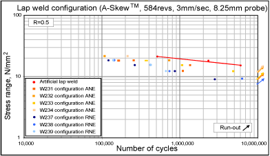

Effect of lap configuration
The effect of lap configuration is shown in Figure 6 & 7, the details of the tool and welding parameters are given in the title of the S-N curve. The data in Figure 6 shows that 'RNE' joint configuration lap welds ( Figure 1a) were slightly better than 'ANE' configuration lap welds ( Figure 1b). However, Figure 7 shows that with a longer probe length and/or slower travel speed 'ANE' type joint lap configuration had better fatigue performance than the 'RNE' joint lap configuration.
Fig.6. Fatigue results of welds carried out with different lap configuration with a 7mm long probe
Fig.7. Fatigue results of welds carried out with different lap configurations with a 8.25mm long probe

Locus of Failure
Since the effective weld width of the Skew-stir TM welds, made using an A-Skew TM probe for this investigation, is nominally 180% of the sheet thickness, failure of the lap welds was unlikely to occur in shear across the weld region. Therefore, tensile fatigue failures for simple lap welds will almost certainly initiate from the notch at either side of the weld, where the secondary bending stress, resulting from the lap offset, is tensile, see Figure 9a&b. Widening the weld will not, in itself, increase fatigue strength, as the notch morphology is of fundamental importance.
Previously lap welds made with narrow, tapered probes failed through the weld region itself in shear or by sheet-thinning or hooking. Making welds of sufficient width means that, providing a solution to the sheet-thinning and hooking can be achieved, lap welds will not fail in shear across the weld region.
