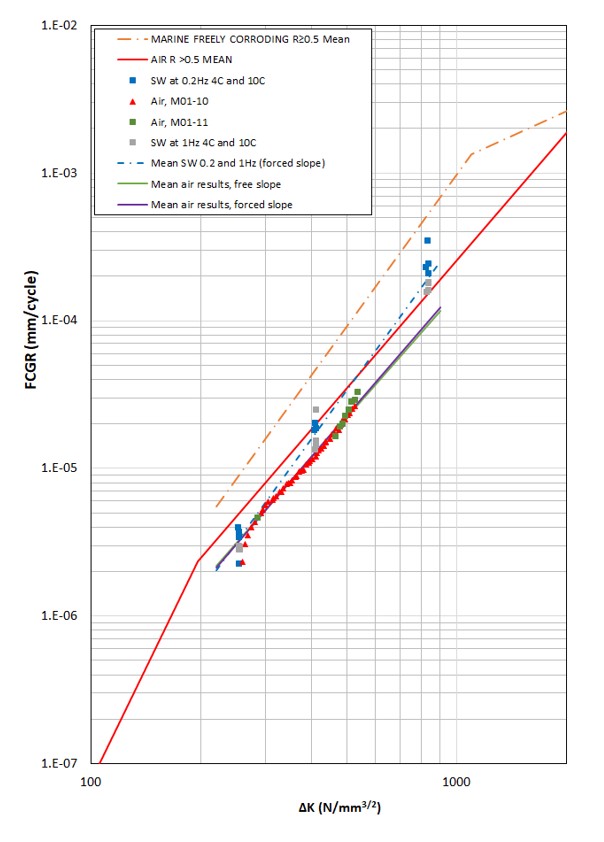

Materials and methods
A programme of FCGR tests was carried out on specimens extracted from 85mm thick plates of Grade S355ML steel. The measured yield strength of the steel was 346MPa.
Single edge notched bend (SENB3) specimens measuring 10 x 20 x 110mm were extracted from the plates. A notch was made by electrodischarge machining (EDM) to a depth of 2mm, and a precrack of 2mm was made at a stress ratio of 0.5.
Fatigue crack growth rate tests were conducted in air at ambient temperature at a frequency of 10Hz, and also while specimens were immersed in 3.5% NaCl solution at 5oC and 10oC. Test frequencies of 0.2, 1 and 10Hz were used.  For tests performed in simulated seawater, specimens were first pre-soaked for a period of 48 hours. No lacquer was applied to the specimen surfaces.
A stress ratio of 0.5 was used for all tests. In all tests, crack length was monitored using direct current potential drop (DCPD) and the DCPD reading was used as an input to the computer that controlled the applied loads in order to maintain a constant ΔK during the tests.
The tests in air were increasing ΔK tests. The tests in solution were frequency scanning tests, where ΔK was held constant and the test frequency was changed after each 1mm of crack growth. Three ΔK values were used (250, 400 and 800 N/mm3/2).
Results
The results are provided in Tables 2 and 3 and plotted in Figure 1, along with the BS7910 R≥0.5 mean air and SW FCGR curves.
The results from the tests in solution included in this analysis were those obtained at a test frequency of 0.2Hz and 1Hz and a test temperature of 5oC and 10oC, to aid comparison with the BS7910 values.
It is clear that the mean FCGR of the new test results, which were obtained R = 0.5, is below the mean R≥0.5 FCGR laws in BS7910.
Comparing the experimental mean curves with the BS7910 air and free corrosion in SW mean curves:
  • The free slope and forced slope mean FCGR curves in air were coincident and the slope matched that of the BS7910 mean in air curve.
  • The air BS7910 R>0.5 FCGR curve was a factor of 1.5 higher than the measured mean air curve.
  • The free and forced slopes of the mean SW results were different.
  • Using the free slope experimental mean curve, the mean SW BS7910 R>0.5 curve was a factor of 2.9 above the measured SW curve at a ΔK of 220N/mm3/2 anda factor of 2.5 above the BS7910 SW mean at a ΔK of 900N/mm3/2.
Comparing the measured air and SW mean curves, it can be seen that the mean air and SW FCGR curves were coincident at a ΔK of 220N/mm3/2 ie there was no measured acceleration in FCGR due to the simulated seawater environment at this value of ΔK. At ΔK of 900N/mm3/2, the SW mean FCGR was a factor of 2.4 higher than in air (using forced slopes) and a factor of 2 higher than air using free slopes.
Comparing with the original database used to generate the crack growth laws for R>0.5 given in BS 7910, the air data generated lie on the lower side of the dataset, but within the scatter. With regards to the frequency scanning data generated in freely corroding simulated seawater, these data also lie within the scatter of the dataset, especially those data produced at a frequency of 0.2Hz.
Summary
  1. The mean FCGR of the modern S355ML steel tested was lower than the mean BS7910 FCGR curves, both in air and freely corroding in 3.5% NaCl.
  2. The measured acceleration in FCGR caused by free corrosion in 3.5% NaCl was less than that of the BS7910 mean curves.
Recommendation
These data should be combined with other data from modern steel and welds and the larger dataset re-analysed to ensure that the FCGR laws in BS7910 are representative of the performance of modern welds and modern steels.

Fatigue Crack Growth Rate of Modern Grade S355 Steel Figure 1
Figure 1: Comparison of test results with the BS7910 R≥0.5 air and free corrosion curves.
