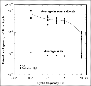

  • da/dN increases with reduction in cycling frequency (between 0.01 and 10Hz).
  • Data presented indicate that increasing the temperature of the sour environment from 30-90°C has no significant effect on fatigue crack growth rate.
However, many of the observations in Ref. [18] and [19] related to the effect of crack closure and corrosion deposits on the fracture surfaces. Such effects were less at high ΔK values and they would be expected to be less, or even absent [16] , at high R. Since it is expected that welded joints in real welded structures will contain high tensile residual stresses, the latter is more relevant and conclusions drawn in Ref. [18] and [19] should be treated with caution.
Fig.6. Effect of cycling frequency on fatigue crack growth in a sour saltwater containing H 2 S at 0.035 bar partial pressure [20] .
