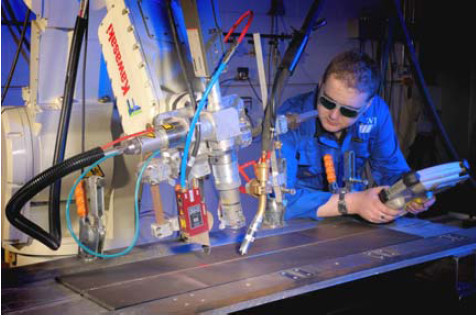

A Servo-Robot Digi-I/S laser vision sensor, as shown in Figure 1, with a V300 Robonet/Master control unit, was used in the adaptively controlled trials and calibrated with respect to the robot. Welds were made over joints with varying amounts of joint gap and/or joint mismatch, with welding conditions being changed in real time. Following trials making fixed changes to welding parameters, to identify which were most appropriate, real-time changes were made by relaying joint fit-up information from the sensor to response programs (in the form of look-up tables) programmed within the V300 or D+ controllers.
Figure 1. A laser vision sensor mounted ahead of a hybrid welding process

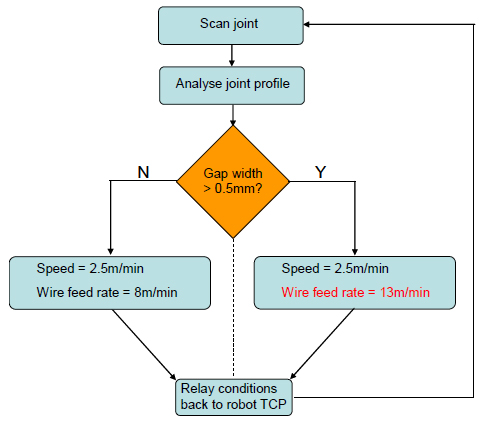

The example in Figure 2 shows how such a table may drive, sending a suitable command voltage signal, an increase in wire feed rate, when a joint gap over a given width is detected.
Figure 2. Example of an adaptive control algorithm

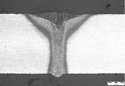

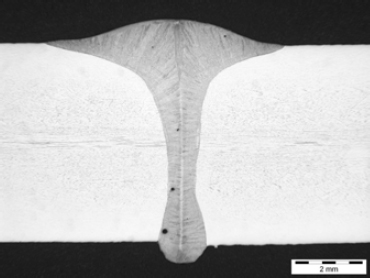

Figures 3a and 3b show, for two material thicknesses, cross-sections of the Class B hybrid welds made over close fitting, flush, butt joints with the optimum conditions developed in the welding trials.
Figure 3. a) Butt weld between 8mm steel plates, made at 1.6m/min, with a wire feed rate 7m/min, and arc voltage trim of -3V

b) Butt weld between 6mm stainless steel plates, made at 2.5m/min, with a wire feed rate 8m/min, and without arc voltage trim

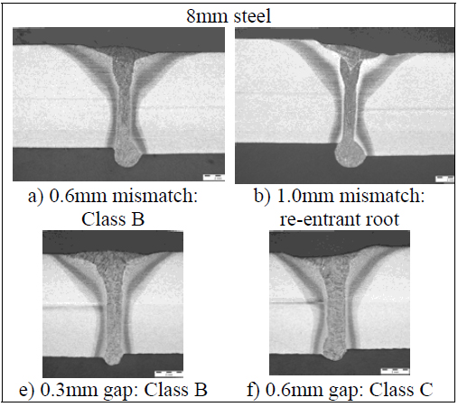

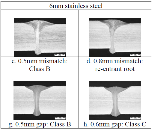

These conditions were also used to weld joints with a mismatch up to 2mm high, or a gap up to 2mm wide. Selected cross-sections are shown in Figure 4. Class B weld profiles were achieved up to a mismatch of 0.6mm (Figure 4a) or a gap of 0.3mm (Figure 4e) when welding the steel, or 0.5mm (Figure 4c) and 0.5mm (Figure 4g), respectively, when welding the stainless steel.
Figures 4a, b, e and f. Cross-sections of 8mm steel welds:
a) 0.6mm mismatch: Class B,
b) 1.0mm mismatch: re-entrant root,
e) 0.3mm gap: Class B,
f) 0.6mm gap: Class C
 Figures 4c, d, g and h. Cross-sections of 6mm stainless steel welds:
c) 0.5mm mismatch: Class B,
d) 0.8mm mismatch: re-entrant root,
g) 0.5mm gap: Class B,
h) 0.6mm gap: Class C
The root toe blend angles became re-entrant on the higher plate if the mismatch increased (Figures 4b and d). Conversely, the cap underfill became unacceptably deep if the gap became greater (Figures 4f and h).

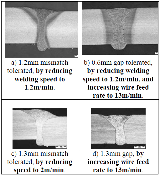

As Tables 2 and 3 summarise, it appeared that changing the welding conditions would give rise to modest improvements in mismatch tolerance and would at least double the tolerance to joint gap. To confirm this, appropriate control algorithms were programmed in to the process controllers, and adaptively controlled trials carried out on butt joints, where the joint preparation, in terms of gap and mismatch, increased linearly as the weld progressed. As the seam tracking device detected changes to the weld profile, an automatic change to a selection of the appropriate welding parameters was implemented. The most successful results are summarised in Figure 5. The benefits (in terms of increased tolerance) gained by using adaptive control can be seen by comparing Figures 4 and 5.
Figure 5. The most successful results from adaptively controlled trials on 8mm steel (a and b) and 6mm stainless steel (c and d) and the tolerances that result. All weld cross-sections are to Class B
5a) 1.2mm mismatch tolerated, by reducing welding speed to 1.2m/min
5b) 0.6mm gap tolerated, by reducing welding speed to 1.2m/min, and increasing wire feed rate to 13m/min
5c) 1.3mm mismatch tolerated, by reducing speed to 2m/min
5d) 1.3mm gapm by increasing wire feed rate to 13m/min

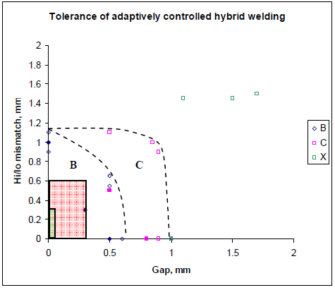

Figure 6 shows the extent to which tolerances have been increased for making either Class B or C welds, including those over a combination of mismatch and gap, in the case of the 8mm thickness steel. In Figure 6, the red and green boxes indicate the estimated tolerances of autogenous and hybrid welding without adaptive control, respectively. Bold symbols are from validation experiments carried out in this work. The dotted lines represent the limits for Class B and Class C welds.
Figure 6. Tolerance of adaptive controlled hybrid welding, in 8mm thickness steel, for class B, C and unclassified (X) welds
