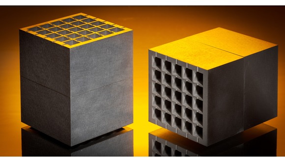

James will be joined by TWI Senior Project Leader, Kandarp Amin during the session, to present the paper, ‘Diffusion Bonding and Brazing of Additively Manufactured 316L and IN718 Components to Wrought or Additively Manufactured Substrates.’ The paper, which will be presented at 15:00, was co-written by James and Kandarp alongside TWI Senior Project Leader, Vaishali Jagannath Prabhu and TWI Section Manager, Dr Nick Ludford.
The paper details an investigation into joining additively manufactured components to either wrought/cast components or to other additively manufactured parts to build larger structures. This research helps address challenges around the limited build size of L-PBF chambers and the subsequent uptake of this technology by industry.
Brazed (left) and diffusion bonded (right) additively manufactured 316L demonstrators
The research developed knowledge of vacuum brazing and uniaxial diffusion bonding of AM 316L and IN718 parts. These joining methods were selected as they are able to successfully join components that have complex internal geometries, such as heat exchangers. This work was designed to allow more industries realise the benefits of additive manufacturing for more applications and produce parts that are either impossible to make through traditional manufacturing routes, or too costly or time consuming to be economically viable.
