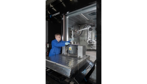

The project assessed the feasibility to use CSAM to produce large-scale components for fusion reactors, including an investigation into the use of vanadium, tungsten, and CuCrZr powders for cold spray. Demonstration components were created to show capabilities such as functional grading. Post processing was also examined, including post-deposition thermal treatments to enhance the microstructural and mechanical properties.
You can see a video showing the operation of the heavy duty rotatory positioners within TWI’s cold spray facility, below:
