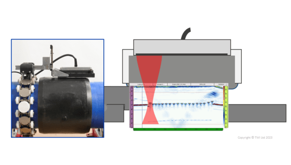

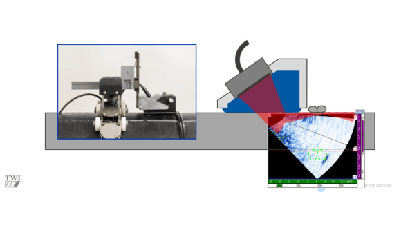

The Polytest inspection system, developed by TWI’s NDT Group, enhances this QA process for butt fusion (BF) and electrofusion (EF) welds, through full volumetric inspection of the welded joint, using Phased Array Ultrasonic Testing (PAUT).
PolyTest comprises a series of wheeled chain-links mounted on to the outside of a pipe, positioned adjacent to the weld to be inspected and a PAUT unit. The chain-link system rotates the attached PAUT transducer around the circumference of the pipe, enabling a full volumetric examination of the welded joint. It is compatible with pipe diameters in the range 90mm - 1,000mm and pipe wall thicknesses between 8mm - 70mm.
The Polytest portable scanner can be used effectively in manufacturing environments, or on-site (both above ground or in-trench) without taking the pipe under inspection out of service. Polytest complies with the requirements of ASTM E3044: Standard Practice for Ultrasonic testing of Polyethene Butt Fusion Joints, ASME Boiler & Pressure Vessel Code (BPVC) Section III and Mandatory Appendix XXVI.

Figure 1. Inspection of a butt fusion (BF) joint, with the ultrasonic beam focussed at the BF weld centreline
Figure 2. Inspection of an electrofusion joint, with the ultrasonic beam focussed at the EF fitting/pipe interface
