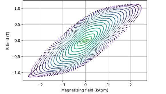

The ZM150 degauss controller from Diverse is capable of measuring and neutralising magnetic fields which may be present in the weld preparation region of steel components. Experiments on thick section (200 mm x 300 mm x 1200 mm) S275 steel blocks suggested the down cycling process to reduce the magnetism from over 100 Gauss to less than 5 Gauss typically takes less than 10 minutes.
Figure 1. Graph showing the demagnetisation cycle, showing nested BH loops as the material is demagnetised
