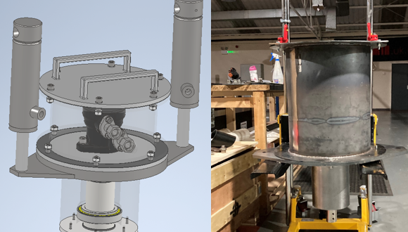

Recent updates from the project include Forth Engineering completing the first (non welding) trial with their underwater patch welding system, designed to weld a flat, circular patch of steel as a lap weld onto an underlying ship hull plate.
This was the first, semi-manual test to ensure the welding head would move around its track, stop, start, rotate, index up and down. For its deliverable weld, this will be done in the vertical plane, although trials are running horizontally at this stage. Ultimately, it will be fixed to a holding frame, which will then be moved into place against the ship side using a ROV.
Figure 1 Concept design drawings becoming a reality. (Images courtesy of Forth Engineering Ltd)
