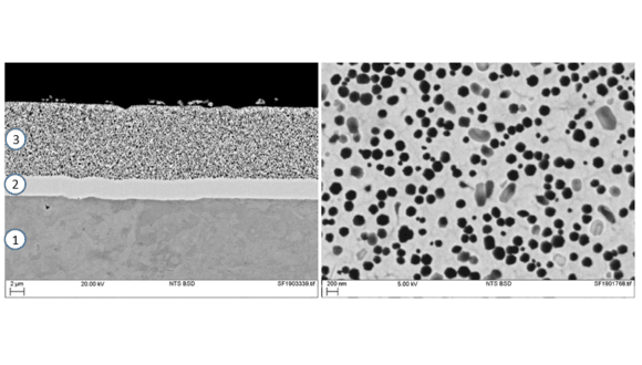

TWI has developed the capability to produce EN composite coatings (by incorporating PTFE nanoparticles homogeneously in nickel-phosphorous based coating,s as shown in Figure 1) for applications requiring anti-fouling properties, hydrophobicity (Figure 2), wear and corrosion resistance.
Figure 1. Representative images of ENP-PTFE composite coating. (left) A back scattered electron (BSE) image of the cross-section of the duplex coating on a steel substrate (1: steel substrate; 2: Ni-P undercoat; 3: Ni-P-PTFE topcoat); dark features in the topcoat correspond to PTFE functional nanoparticles. (right) High resolution BSE image of the Ni-P matrix with embedded PTFE nanoparticles

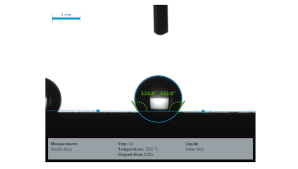

Figure 2. Static water contact angle measurement on Ni-P-PTFE composite coating demonstrating its hydrophobic nature
