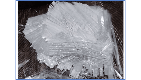

Figure 1. Segment of GFRP from End-of-Life Wind Blade

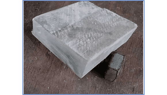

Figure 2. Clean Glass Fibre Reclaimed via DEECOM®
