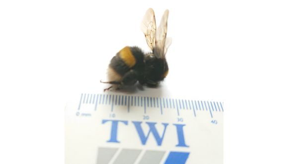

On one morning after a very hot day, when entering the radiography laboratory at the TWI Wales office, staff were surprised to see an unexpected visitor lying on the floor. This visitor was a rather large bumblebee that looked to have expired due to exhaustion, as there appeared to be no physical damage to its body.
Figure 1. Bee with ruler

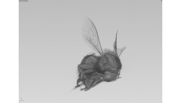

Figure 2. Bee 3D rendered showing hair

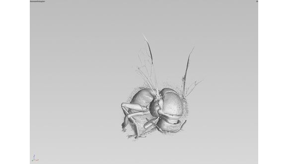

Figure 3. Bee 3D rendered to show outer shell with dust in hair visible

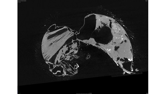

Figure 4. Bee 2D side view image slice
