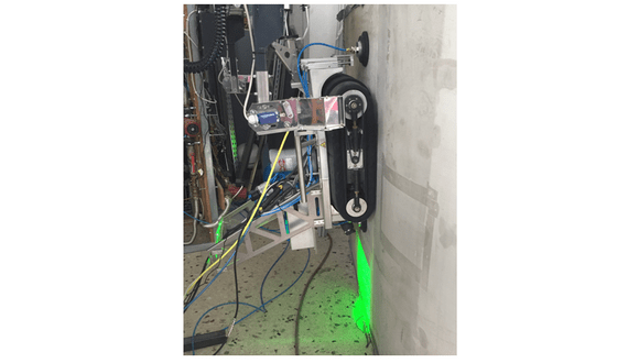

Figure 1. SheaRIOS blade crawling robot performing shearographic inspection on a section of wind turbine blade

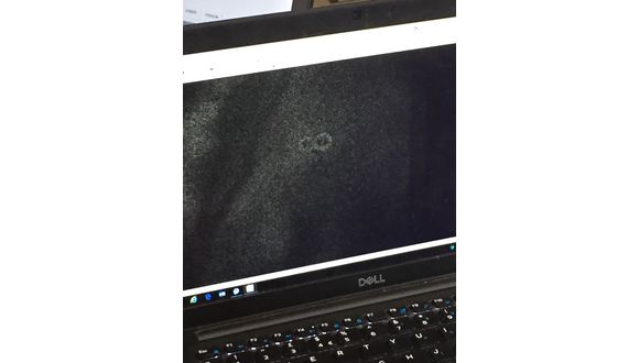

Figure 2. Artificial defect successfully detected by the SheaRIOS blade crawling robot with shearographic inspection payload (i.e. classic ‘butterfly’ shearogram indication)
