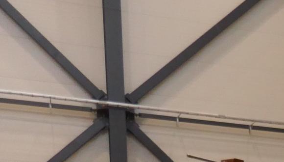

BladeSave project partners implementing the full-scale testing at Blaest, Denmark
