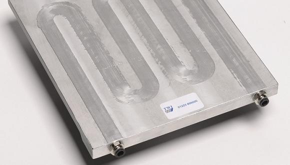

Cooling plate demonstrator (a) General view

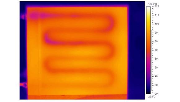

Cooling plate demonstrator (b) Infrared thermal imaging evidencing circulation of liquid coolant through heated plate demonstrator
