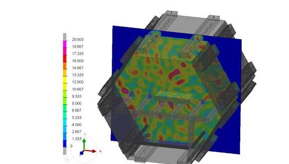

The SIMUTOOL project started in September 2015, to develop a simulation platform for the manufacturing of composites through microwave (MW) heating. The simulation includes an electromagnetic field coupled with heat transfer mechanisms that take place during the production process. It also includes the process control loop which enables the optimum design for the manufacturing process. One of the major outputs of the simulation platform will be the successful design of a ceramic matrix composite tool with an MW absorbing layer, in order to maximise the energy saving potential of the MW heating process. The project addresses the manufacturing issues of MW heating of composites, which stem from the lack of understanding of the basic physics of the process.

Simulation of microwave field distribution
