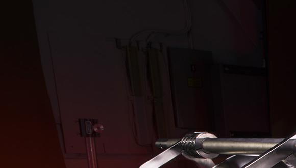

TWI and Shakespeare will produced this superconducting radio-frequency cavity which is one of the central features of the PIP-II particle accelerator project at Fermilab. PIP-II will use strings of these cavities to propel particles to around 800MeV, or 84% of the speed of light.
Credit: Fermilab
TWI and Shakespeare will produced this superconducting radio-frequency cavity which is one of the central features of the PIP-II particle accelerator project at Fermilab. PIP-II will use strings of these cavities to propel particles to around 800MeV, or 84% of the speed of light. Credit: Fermilab
