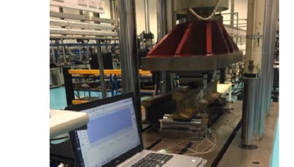

The OptRail consortium, comprising RCM2 Ltd, TWI, Brunel University London, Yeltech Ltd and Surrey Advanced Control Ltd, recently met for their fourth quarterly meeting at TWI, Cambridge. The consortium shared updates on the simulation of the mechanical strain in the centrally loaded rail, and the selection and installation of Fiber Bragg Grating (FBG) sensors. The sensitivity of the sensors was evaluated in a lab test using a four-point bending test rig to perform static and dynamic loading on an intact track test piece.
The next steps in the project will be signal processing and failure data analysis, and further experiments with increasing defect size are planned to evaluate the sensitivity of sensors from other locations.

Experimental setup using a four-point bending test rig to validate the sensitivity of the sensors
