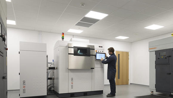

SLM additive manufacturing at the TWI Technology Centre - Yorkshire

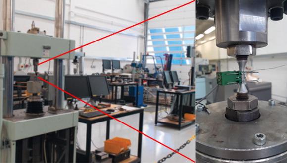

Strain-controlled fatigue testing at HBM Prenscia's 'Advanced Materials Characterization & Test' facility
