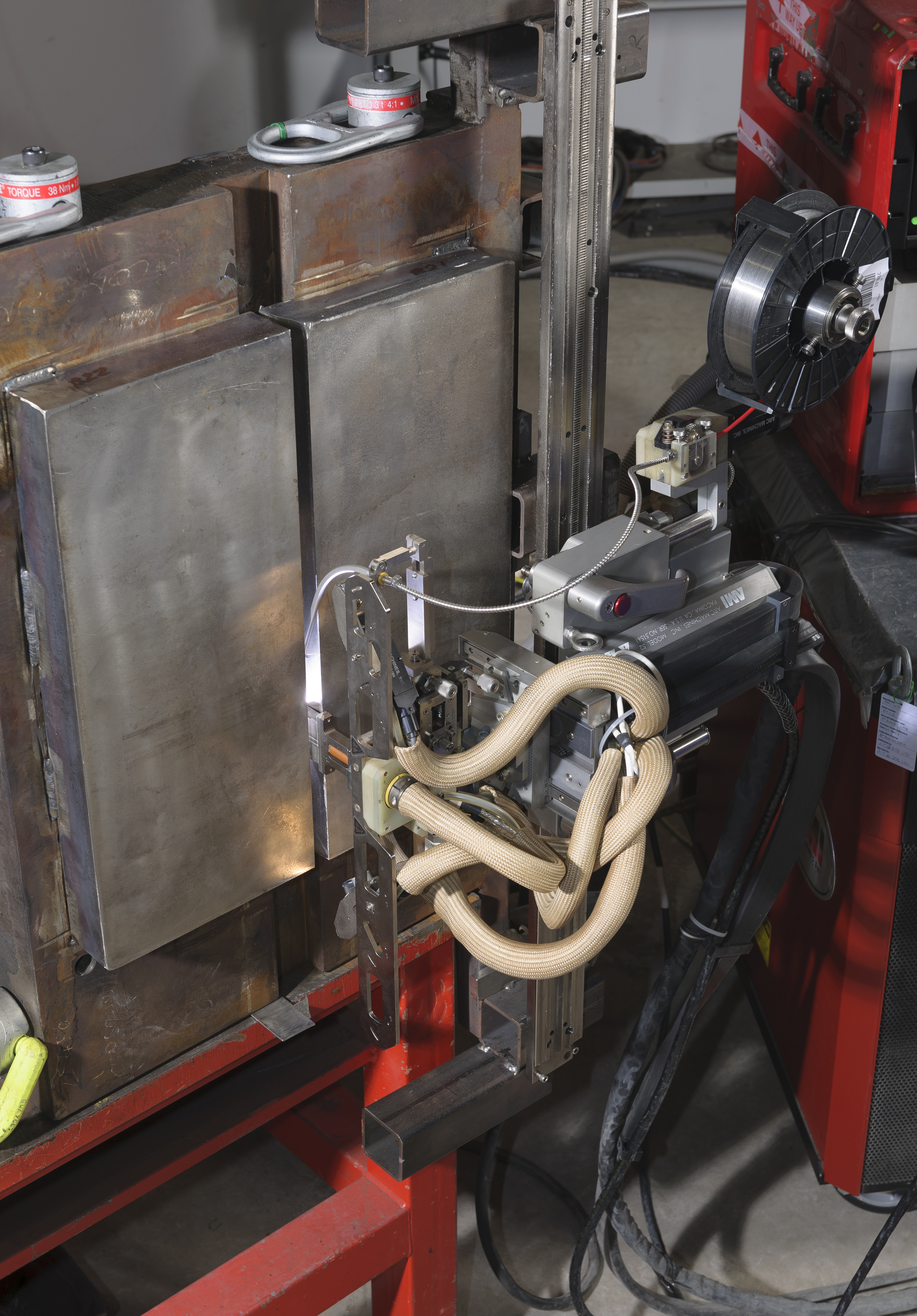

TWI Member company, Arc Machines Inc. (AMI) have lent TWI a Model 415 WDR computer controlled TIG welding power supply and a Model 52 heavy-duty precision automated orbital weld head for use on a core research project investigating defects in stainless steel welds.
The project, which has applications in the power industry, is looking to link the performance of ultrasonic inspection with the parameters of the weld in order to mitigate the effect of material properties on inspection.
This involved purposely placing defects in material that is representative of welded stainless steel blocks. These blocks will then be examined in order to improve and validate NDT inspection techniques.
The project examined different welding processes, including narrow gap TIG welds, which are in line with processes used by industry.
AMI’s equipment was loaned to TWI and is currently being used on the project at our base in Middlesbrough.
The outcome of the research should provide useful information for a number of TWI Member companies going forward.

Narrow gap TIG welding/ Model 52 heavy-duty precision automated orbital weld head in use
TIG welding of narrow gap stainless steel
