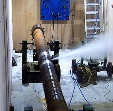

The resonance fatigue testing technique applies a fully alternating stress range.  The applied stress range varies from fully tensile to fully compressive in each cycle, about a mean stress equal to zero, i.e., the ‘stress ratio’, R, is equal to -1.
To ensure that the weld root was in tension during testing, a mean stress was applied via internal water pressure.  Since the pipes were thick walled, a high internal pressure (16,800psi, 1158bar) was required to produce a 100MPa axial mean stress.  This ensured that the weld root was in tension throughout testing.
The pipes also had a large diameter so the stored energy associated with the pressurised water was higher than could be accommodated by TWI’s
standard safety containment frames.  In order to carry out the tests safely, a resonance test machine was therefore relocated to TWI’s pressure pit test facility.  This is a fully reinforced pit with a burst proof lid so that the test specimen is fully enclosed during the test.  In the unlikely event that there were to be a catastrophic failure of a test specimen, all fragments would be safely contained without any risk to the operators.
In this project, six resonance fatigue tests were successfully carried out.  Five of the tests ran until through-wall cracking occurred, as detected by a decrease in the measured internal water pressure (see the Figure).

A thick walled specimen on test in a TWI designed resonance fatigue test machine, located in TWI’s pressure pit test facility. Water can be seen escaping from a through-wall fatigue crack
