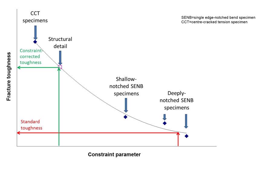

TWI’s analysis used the concept of crack tip constraint, as codified in the latest (2013) edition of BS 7910 ('Guide to methods for assessing the acceptability of flaws in metallic structures') to address this question. Essentially, test specimens and structures under predominantly tensile loads (and/or containing shallow flaws) have an effective toughness that is higher than that determined from standard fracture toughness tests on deeply notched specimens in bending. This difference can, in principle, be taken into account by testing a variety of specimens with both high and low crack tip constraint, and generating a relationship between toughness and constraint. A schematic of the method, described in Annex N of BS 7910:2013, is shown below.
By calculating constraint parameters for both the small-scale specimens and the relevant parts of the platform, it proved possible to demonstrate enhanced fracture toughness for selected structural details, which in turn contributed significantly to the overall safety case.
